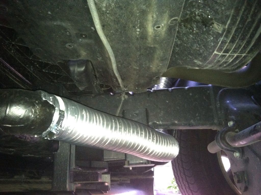

I agree, whether the tube is ribbed or not is of little concern before the filter box,
...provided you give it enough Volume.
That's why I have Two Flex tubes almost at 4" each.
When I had my wheel well liners out to do my header install recently
I got a good view of the one that runs to the underside of my Volant and the one that leads up to the stock fender opening.
from the front:
from the bottom looking up
