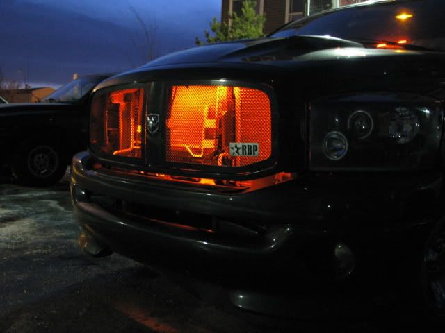

Looks awesome Cantu! How did you wire them in? I have mine run to a relay off my dome light, so they come on when I open the truck but turn off when I drive. Thought about that? Would keep the bears off yer tail
Here's my setup:
I spliced the fogs, so when I turn my fogs on they come on, I might just put a manual switch because I am planing on adding more LEDs around the truck, but that's another story man.

I'm going with more LEDs as well. To make it easier for joining all the LEDs to a single input line, pick up a distribution block it'll make life a lot easier. A manual switch would work nicely provided you have a single line activating all the lights.
