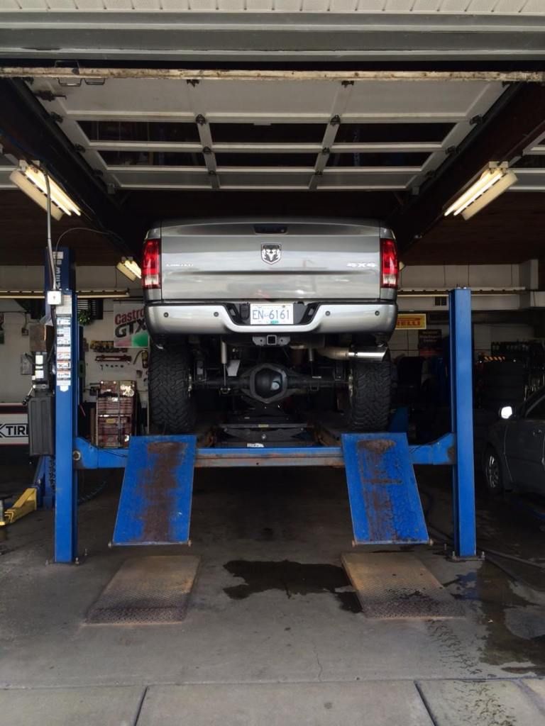

I had an appointment to bring the truck in to Kal-Tire in Abbotsford on Saturday. So I showed up there just before 12:00 for the appointment and handed them the keys. Within a few minutes they had 3 of their techs out there looking at the truck, I assumed they were just checking it out. Well they ended up coming back into the office and told me they couldn’t do the alignment on my truck because my tires are too big. I know how most alignment machines work and have used them so that made absolutely no sense to me. So I went out and talked to the alignment tech directly to find out what was going on. The alignment machine they have uses cameras that point to each other across the truck. So they couldn’t get them far enough away from the rim with the 37’s. So I started calling around to every tire shop and dealership in the area to see if I could get it in. No dice…. So the alignment was going to wait. I wasn’t too worried about it anyway since the toe hadn’t been touched, the camber is unadjustable, so only the caster could be out and the drag link just needed to be adjusted to center the steering wheel. So I went home and adjusted the drag link myself to re-center the steering wheel and called it good. I was away all week for work so the truck was only driven to the airport and back. I then made an appointment at the tire shop I got my tires from (OK Tire) for the following Saturday.
When I brought it in there they got it in right away. The one issue we ran into there was that my truck was too tall…. They couldn’t put their hoist as high as they normally would because my hood would have hit the heater they had hanging from the ceiling. But it would work where it was at. Turns out that the caster was almost dead on where I set it. Close enough that they weren’t going to change it. They did adjust the toe slightly and then re-centered the drag link again and it was good to go.

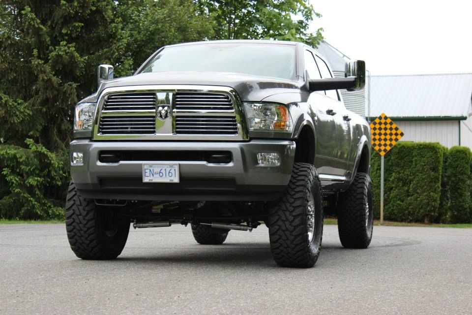

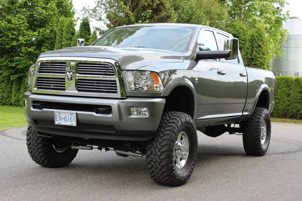

Pictures:
I didn't end up washing the truck before taking pictures since it's supposed to end up raining here for the next few days. But it looks pretty clean on the pictures anyway. Ignore any dirt/crap you see.
