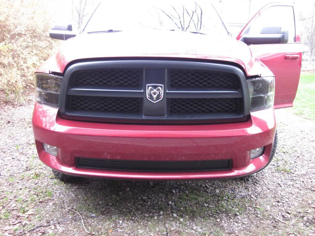

I would go with the retroshop projector retrofit headlights. That is what the HID lights are made for and you will get the best light output with that set up. I have had Retro fit headlights in my cars since 2003 and have never looked back.
This is what I have. sorry for such a crappy pic.
This one is a little better.
