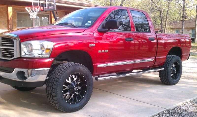

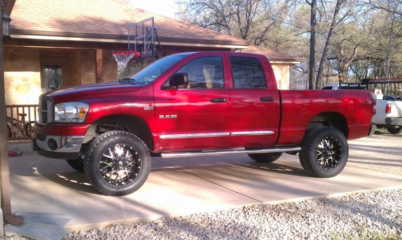

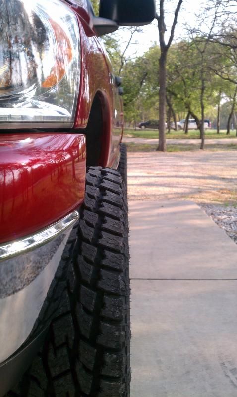

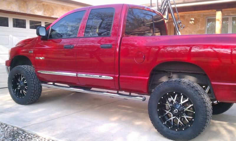

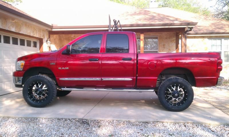

My 2008 1500 2wd with Maxtrac 7" kit. 4" suspension lift. The 7" comes from the spindle length. Bilstein 5100s all the way around. Dropstar 20x9 (0 offset) wrapped in Toyo Open Country AT II 35x12.50x20

Looks great! Sweet rig...
