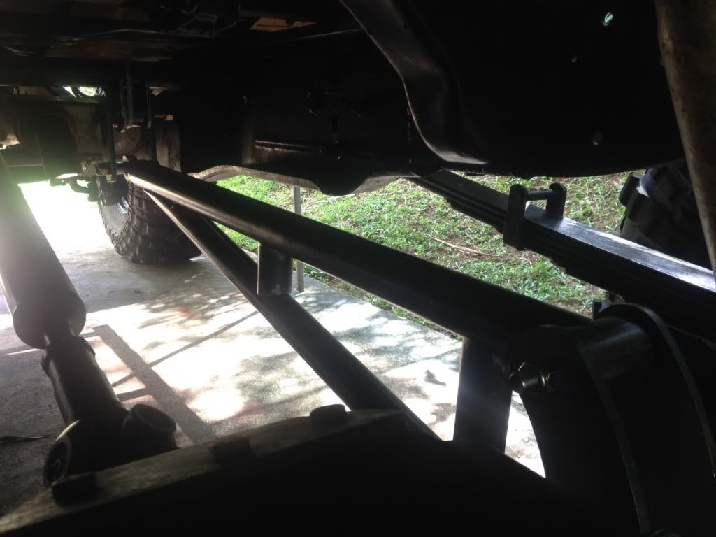

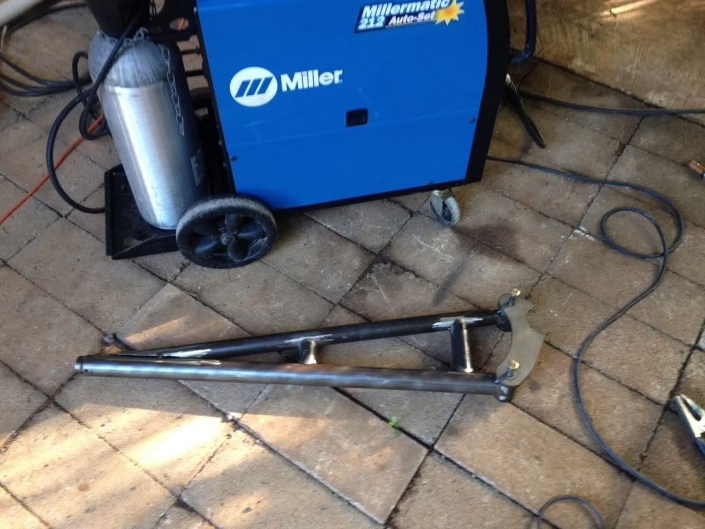

Anti wrap bar fabbed up and tacked together, just need time to weld it all up.

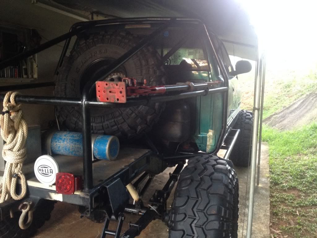

Air tank and hi-lift mounted.
Anti wrap bar pics
Material is 2" .25 wall DOM
I'm gonna also weld it to my axle truss so no spinning axle tubes here.

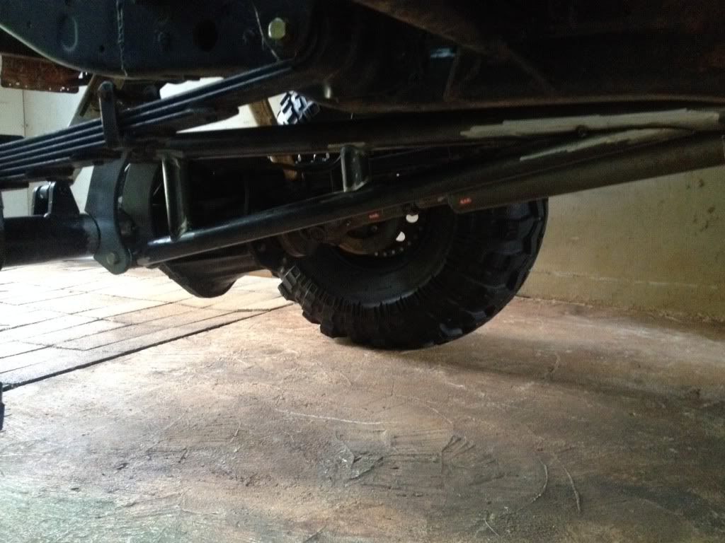

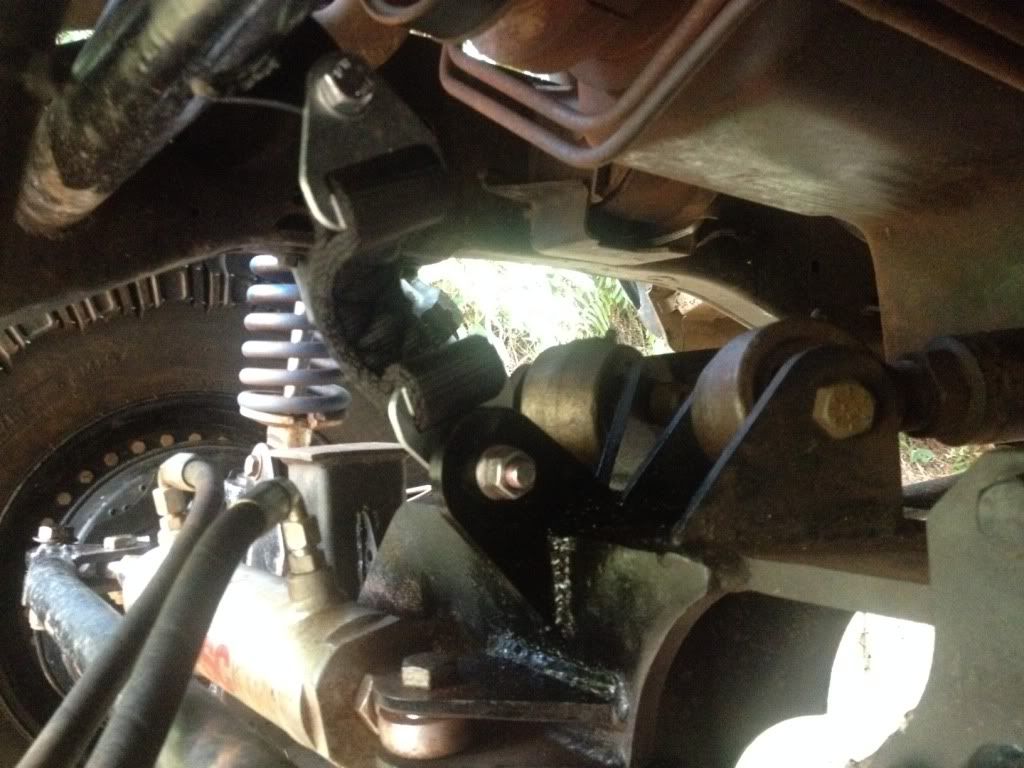

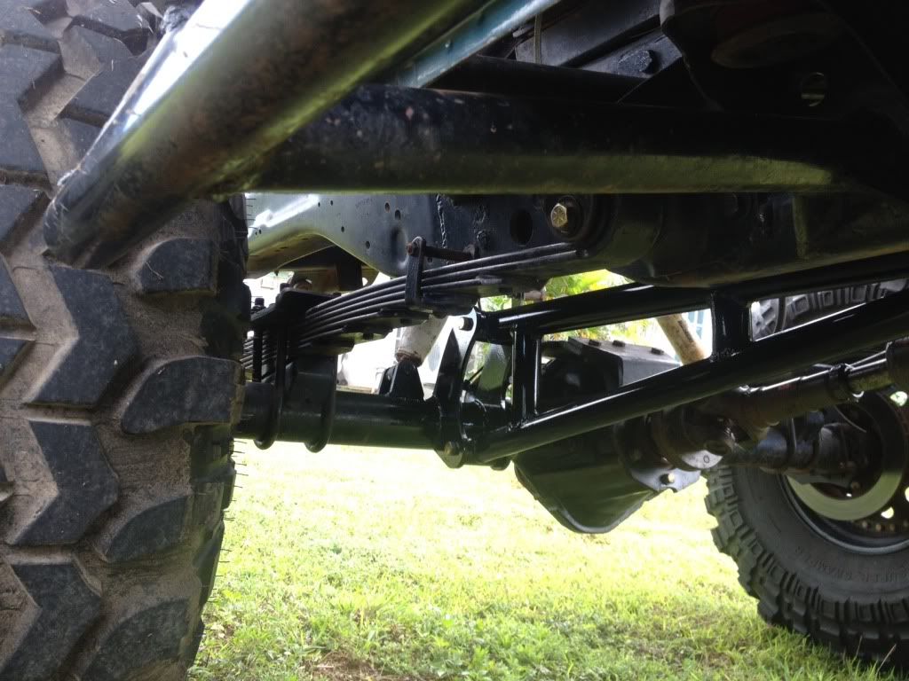

Sorry no real big updates, I haven't had any days off in the last couple weeks and it doesn't look like I'll get any time off till next year. I was able to finish welding up my anti wrap bar, cross member, exhaust, and limit strap tabs on the front axle.
Finally installed my limit strap on the front axle.
Cross member and shackle angle.
I had to shorten my exhaust 2 feet to fit the bar in.
Soft Alcan springs going negative when checking if the anti wrap bar limited my suspension travel (it didn't).
Sorry for the poser pics but I haven't had time to wheel and I wanted to check the travel on the rear after the anti wrap bar.
The R.T.I. rock in my back yard is about 4 feet tall and you can see I'm nowhere near maxing out my suspension in the rear.
