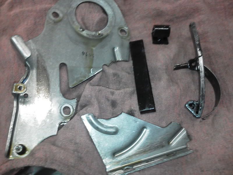

Well, if it's what we've been seeing for a while on the LXs with the 5.7L, then it's the eagle engines with a few older ones thrown in for good measure. The timing chain tensioner spring fails causing the timing chain to hit the slider which will basically break the slider into several pieces and sometimes crack the thrust plate. It has happened on a few stock vehicles, but typically it's seen with mildly modified engines. The basic fix is to swap in a 6.1L thrust plate and there will be no issues. You can tell the difference between the 6.1L thrust plate because it's black and the 5.7L one is silver/grey. Just the fix that the LX guys have been doing for the past few years.
Thanks, CdnoilRAM. That sounds like a fairly comprehensive report on what Ram Tech might be referring to. And thanks for that pic.
That looks particularly nasty, is this how our RAM Hemi's are configured as well ? Haven't heard of this failure on the 4th gen Rams, should we be concerned about this.
Eagle engines are what powers the 4th gen hemi Rams, so...

Keep in mind that this isn't a common failure, and that picture is a worst case scenario. Most times we've must found that the slider spring has failed but no damage has been done, but we only know when this happens when the timing cover is pulled.

So will this start happening more and more as the 4th gen RAMs age ??? If this is an issue I would rather take care of it now while everything is running smoothly. Any good aftermarket parts available, like beefed up tensioner and timing chain ??? I really hate hearing about stuff like this, first the pinion nut and now this

I've heard of this rumor also, an instructor at the chrysler training center mentioned that 1 or 2 5.7l challengers in the area had some major timing chain failure and destroyed the engines, that was about 6 months ago. I haven't seen anything at the dealer yet.
About a year ago I replaced a timing chain tensioner on a 2009 hemi ram because of a rattling noise, don't know if its related.

Hi, Im more active on the Charger and Challenger Z, it seems like this has been an issue we have been seeing on 5.7L only and from around 2010 models on up. I have seen this for the past year on the Challenger site. Seems like alot are switching over to the 6.1L timing set FYI
