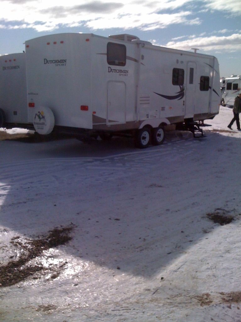

This is what I'm going to be pulling this year. 9690lb GVW. 840 Hitch. Equalizer cut's it down to 420 on the Hitch.
