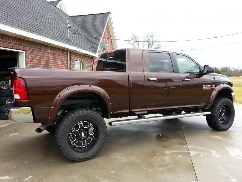

Here's a few pictures on my 2013 Ram 2500 Mega Cab
-Fabtech 6" Lift
-22" Moto Metal Wheels
-37" Nitto TG's
-Bushwacker Flares
-Nerf Bars, Ram wheel to wheel
-Roll-n-lock bed cover
-Bedrug Liner
-B&W drop hitch
2013 2500 MEGA CAB with 6" Fabtech, 22"s w 37 x 13.5 NittoTG's, Bushwacker Flares & a few more
