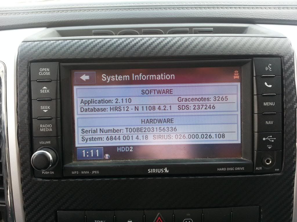

so i want this black screen really bad so just to make sure doing gonna ask you the steps
so go to like
log on using soxs username, clicked on my gig software update, software gracenote update- rhr rhw rhp update 2011+ - then download rhr rhw rhpiso??
is this the correct update??

what one would i need first this is what i have now
Unfortunately you have a different radio (looks like RHR?)
and a different version of the software (2.110), so you would need a different update.
