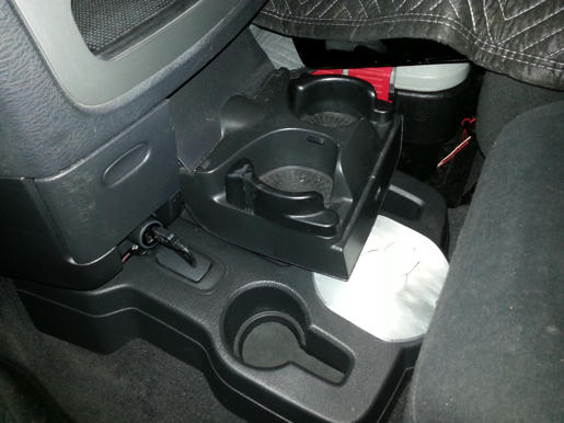

Here are some pics from my latest upgrade...
I installed a floor shifter console out of an SRT-10 pickup. Rather than simply cover the hole for the shifter boot, I made a custom aluminum cover and turned the area into a tissue paper dispenser.
This unit is also meant to be installed with a dash mounted map pocket but I wanted to retain the OEM fold down cup holder. I had to do some trimming to make it fit but it looks good and functions exactly as desired.
