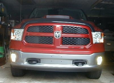

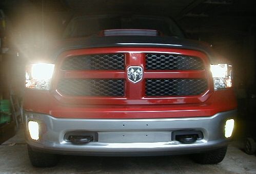

I ordered HID"S from DDM Tuning ( http://www.ddmtuning.com/ ) and installed them in my 2013 Outdoorsman to replace the OEM 9600 fog light bulbs.
Parts installed: Total ($57.47) delivered.
35 watt slim ballast KIT with 9600 replacement bulbs @ 3000K color yellow ($29.95)
HID wiring harness duel in/out ($9.99)
Shipping ($17.53)
Everything is plug-n-play so the install was easy. About a 2 out of 10 difficulty.
I have used HID kits from DDM Tuning on 3 other projects so I know there HID Kits and the quality of parts.
I tried to install the HID Kit without the wiring harness first, but the lights would only flicker, shut down and not light. Then I installed the HID wiring harness and the bulbs light right up.
When the HIDs bulbs light there is no flicker, no bulb out warning, and no TPMS warning. Everything works as it should and I am pleased with the install and I like the yellow color of the fog lights.
Sorry for the picture quality, I tried to get the fog lights to show the yellow color.
I have quad headlights. Picture 1 with lowbeam headlights and fog lights. Picture 2 parking lights and fog lights. Picture 3 just the fog light.
Greg

An HID kit for under $60! Wow! Never seen that kind of deal before. The other 3 times you've used them have you had any problems at all? Bulbs burning out our ballasts stop working?
Do you happen to have any pictures of your install?

OP, do you ever have anyone flash you with your hid fogs turned on? Biggest reason I don't do the headlights is blinding people.
